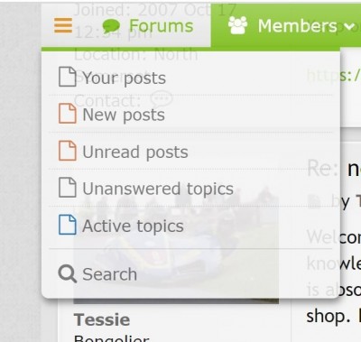

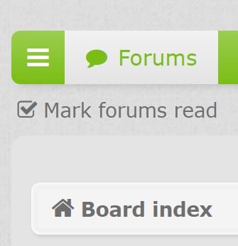

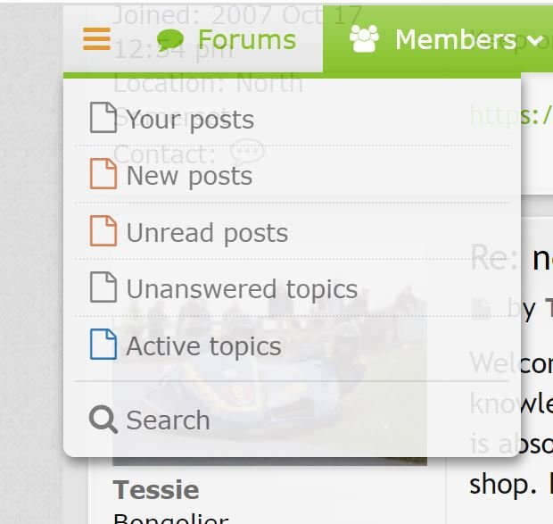

The Hamburger (3-layers) menu at the top left is a good way to find your own and new things,
after that you need to choose which area of the forum you want to use by clicking the "Forums" button also top left;
