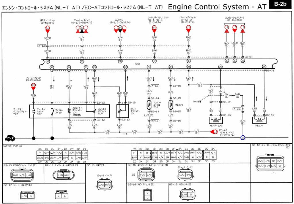

Re: A transmission fault code that's not on the list...
So, update...
The HOLD light would flash immediately when the ignition was turned on - I adjusted the TPS a little, and now the light only starts flashing when you accelerate hard...
So I think I just need to adjust the throttle position sensor.
My question is - is there anywhere that has a guide on how to do this? There's a bunch of threads on here referring to the Bongo Wiring Manuals - but they are now dead because Flash got deprecated. There's some others showing the right pin on the ECU in a picture... that's now broken And the search doesn't like three letter terms - so ECU and TPS are right out...
I really just need to know where I need to attach the multimeter in order to calibrate the TPS correctly and then I am golden (I think). I know that with the ignition on, I need to adjust is so that the voltage at the ECU is 1.3v closed, 4.2v open with reference to the vehicle ground.
Can anyone help me identify which pin on the ECU I should be testing?
The wiring diagrams won't help you there you need to adjust the TPS for the correct voltages on the ECU as in the engine manual.
See here viewtopic.php?p=566167#p566167
Its the Orange/White wire on the 2I connector
