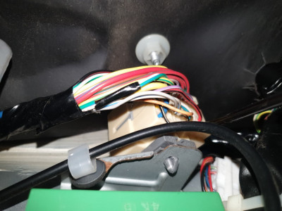

The diagrams are not that useful in this sort of work, the only way of finding the short is visual inspection! If you've played with the tailgate and it cleared check carefully the loom within convoluted rubber tube that joins the tailgate to the chassis top right of tailgate, a common place for breaks due to the stresses.

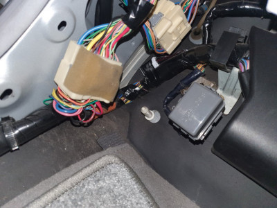

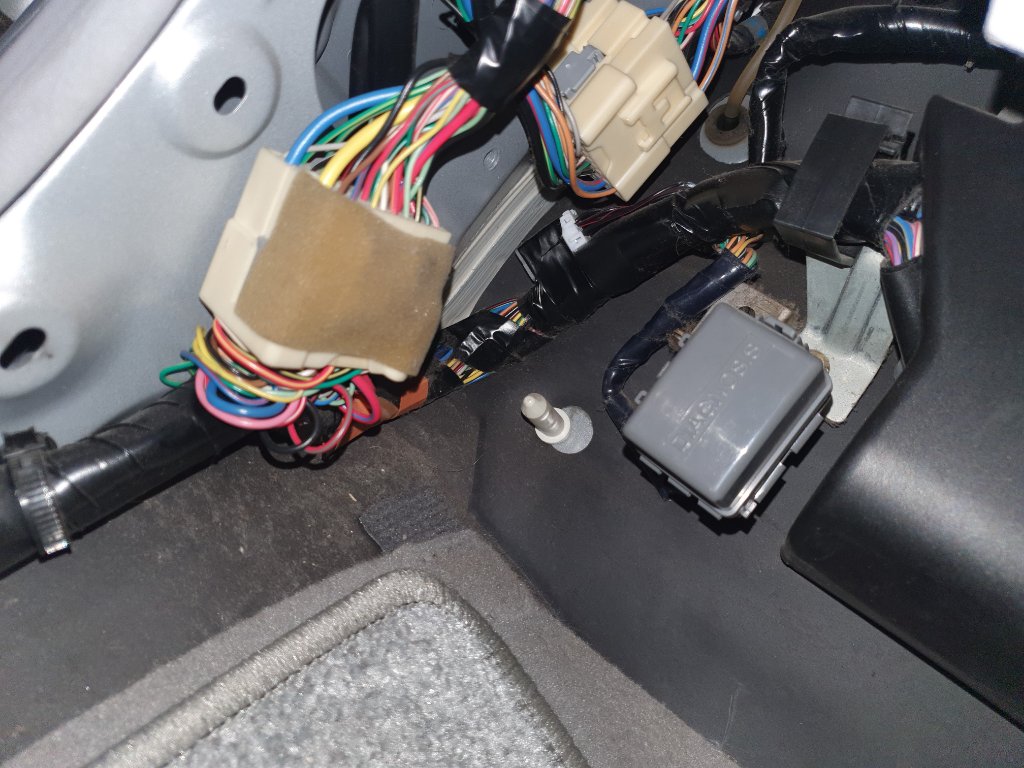

So, been chasing this fault now for another week.
I disconnected two connectors under and to the left of the glovebox, which I saw had the side light cable (Green/red). I did this to try and isolate the looms to the tail.
No fault, put connectors together... no fault. Thought I’d fixed it. Now, fuse blowing again. Fuse now blowing with those two connectors disconnected.
Does anyone know if there are any more connectors which head to the rear of the bus?
If I put a continuity checker from the Green Red cable to Ground... what should I get? I’m obviously thinking I should get no continuity when lights off (or fuse out).... but can anyone supply any more info?
Where does the lead from the fuse box under the bonnet go to get distributed?

Disconnected the dashboard and fuse blew again so not coming from here.
I guess like HairyBeard did I should be disconnecting looms on both side (near glove box and close to gas pedal) that go to clusters, it would help me to figure out if short comes from the front or the back of the vehicule right?
Never came across those connectors, any tips on disconnecting them? Can see a grey T shape piece in the middle that looks like it wants to be pushed.

Post by Northern Bongolow » Fri Jul 30, 2021 11:11 pm
Like Geoff says earlier, check the wiring that goes from body to tailgate top right of tailgate, number plate lights construction are not one of Mazdas better design efforts.
The wires are inside a rubber boot and usually are broken.
