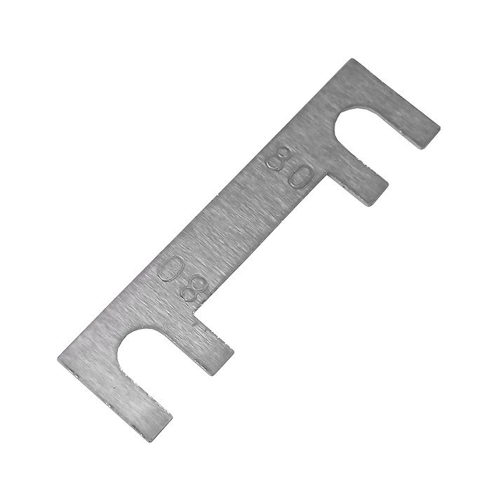

That's meant to be a link fuse like these which have the rating stamped in them;
Its been replaced with a wire to act as a fuse :-(
The fuse is there to protect the wire itself that is doing the connection to the Split Charge Relay, so you normally set the value as the same for the gauge of wire being used or slightly less. I can't see the gauge of wire but I would be looking to replace it with something around 40 Amps, possibly higher, maybe worth checking to see what fuse is on the Leisure battery connection there is normally an identical fuse protecting the wire from leisure battery to Split Charge Relay.

Yes that's right, someone blew a fuse - by the way if one fuse blows ALWAYS replace BOTH fuses, they are in series - as the second one will be damaged as well and it will fail at the most inopportune time possible!
Might be worth having a few spares https://www.ebay.co.uk/itm/191988746550
