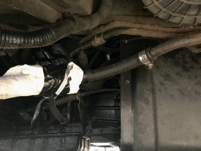

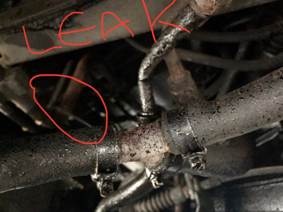

Hi, all. Some quick questions as a new Bongo owner:
1) I grazed the attached pipe on the kerb going onto my drive. Located half-way down the driver's side. It was spurting warm, pink fluid (circled) under pressure. What is it? Coolant? If so, where is it going that far back? ATF? With some brute strength & ignorance I wriggled the hose and the "squirting" stopped but I need to keep an eye on it when I next go out.

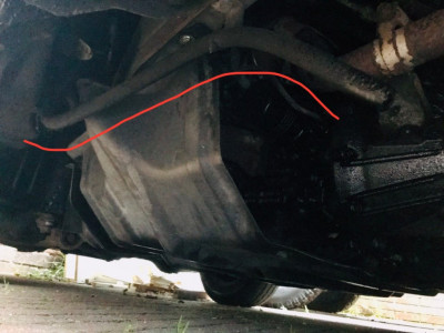

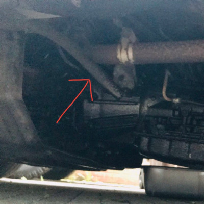

2) Engine smells strongly when stationary. There is a second pipe on the passenger's side (see message below) that blows like a mini exhaust, which I assume is the cause. What is this? Crank gas outlet? Is this a sign of (very) worn piston rings/seals? How concerned should I be? Engine is 2.5L WLT diesel, 97.5k miles since 1998. Fix or tolerate?

"Mini exhaust" pipe on passenger's side:

Your first post and the leak sounds like your engine coolant if its red and water based rather than Dexron3 which is red but oil based for the gearbox.
In which case its the pipes going back to the rear heater and air con. The coolant system as you most likely know is a sealed system and is pressurised by the heat of the engine to help it remove more heat. So check your coolant level when cold and top up with the same coolant type which is likely a Red OAT based coolant additive.

That is the gearbox breather pipe , its parted company with the gear box, it goes into the engine bay as you said ,and attached to the rear of the engine. It would be worth while having the breather system serviced.

g8dhe wrote: Tue May 03, 2022 9:55 pm In which case its the pipes going back to the rear heater and air con. The coolant system as you most likely know is a sealed system and is pressurised by the heat of the engine to help it remove more heat. So check your coolant level when cold and top up with the same coolant type which is likely a Red OAT based coolant additive.
Hi, these three hoses (joined by a Y-shaped plastic junction) have given up the ghost and are spewing coolant out. I've repostitioned and tightened the hose clips but to no avail. I've had a look for the diagrams and part numbers so I can replace them on http://www.lushprojects.com/bongopartsm ... 1of02.html but can't see it - the diagram just shows the coolant route back to the radiator top hose from the water pump outlet. Can anyone help?
