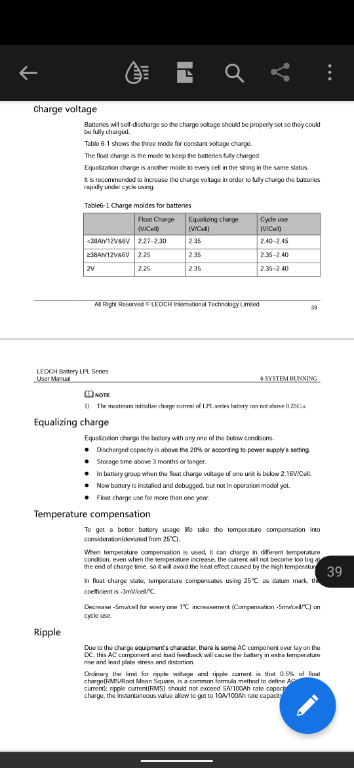

This is what the battery manufacturers sent about charging, saying all the info is on here... Could be written in German to me! Means nothing!!
Posts: 10963
Re: Solar charge controller setting for AGM battery
Post by g8dhe » Mon Sep 26, 2022 12:04 pm
Just choose "Deep Cycle Sealed" for the battery type and that is all that should be necessary, it will (according to the manual) adjust the parameters itself over a few charge/discharge cycles.
