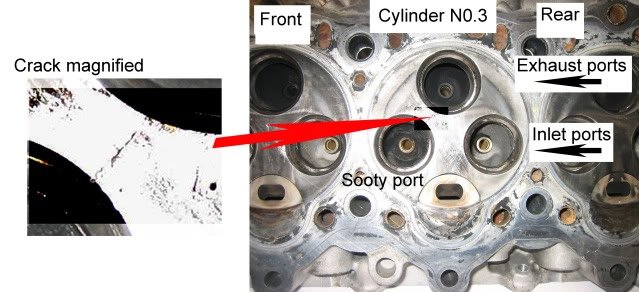

Continual bubbling could be from a cracked head letting combustion gases into the coolant, did you run for any time/distance with the leaking radiator which might have caused an overheat ?
Its a very common problem like here https://igmaynard.co.uk/bongo/forum/vie ... 53#p722853
They appear as below when the head comes off;

There were prior issues, unfortunately the reason it went to be checked out by the garage was because it was overheating. I'm sure you are right and it is a cracked head!
Before I order a new cylinder head and attempt to replace it, do you have any tips for how I can confirm that it is infact the head that needs replacing, or is it just a case of getting it out and having a look?
