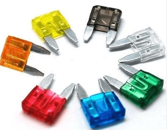

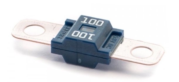

My Starter and Leisure batteries look to have different fuse types fitted.
Starter (100W I think) looks like this:
Leisure looks like this (40W fitted):

by g8dhe
The fuses you show look like the normal vehicle fuses, the two used for feeding the relay will have been added normally in-line fuses in there own holders close to the batteries where the wires feeding the relay are terminated.
