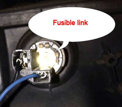

No that will be fine for charging, the sockets are however fused at 10Amps so make sure you don't draw too much current, because there are two fuses one is on the back of the socket itself and is rated at 10 Amps, they are best bridged out if you do blow one. The second one is in the internal fuse panel rated at 15 Amps (top right ancillaries) and protects the wiring itself below is a picture of the link/fuse on the back of a socket they are a right pain to get at as well!
