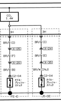

Found NOTHING on the dipstick, worryingly (even if stranded on a slight slope) After adding 3.5 litres of 5W30 she now shows FULL on the stick when cold:: but is this too much? Clearly I need to check oil more often..
That made me wonder whether oil starvation is detected, whereupon oil warning lights-up which cuts ignition? (the opposite of my assumption about Friday breakdown: namely ignition/engine stopped, causing an incidental warning light as oil pressure fell).

The dashboard light is merely an Oil Pressure light to indicate that there is a problem, it controls nothing else other than the light;
However its worrying that you could fit 3.5l of oil in that would tend to indicate that you had lost a lot as the total is 4.5l in the specifications!

Ah thanks Geoff. Sounds much more likely the Oil warning is just the effect of the engine cut-out then, not the cause.
