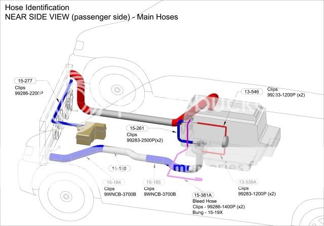

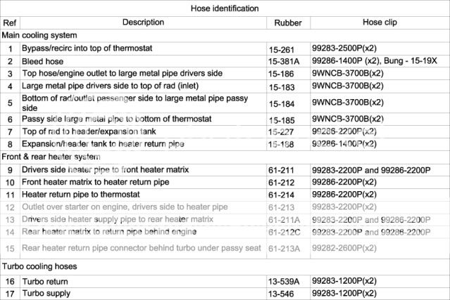

Hose, pipe and clip list
Main hoses - near side (passenger)

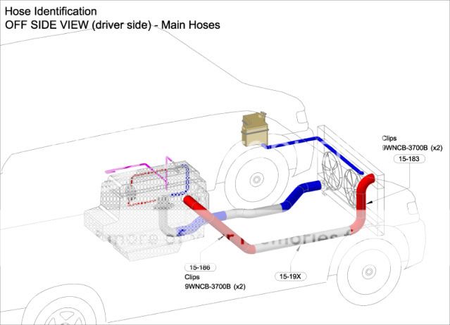

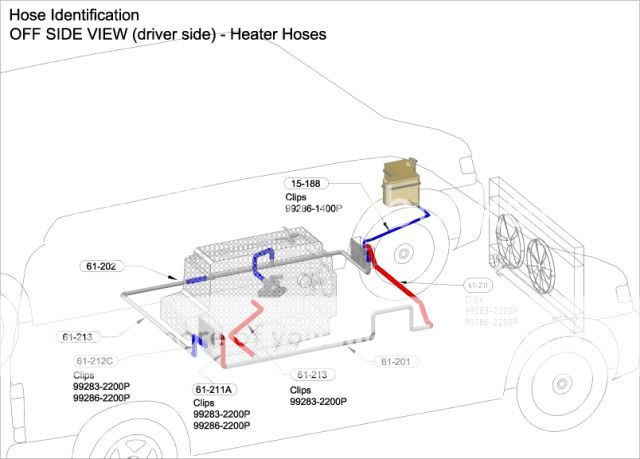

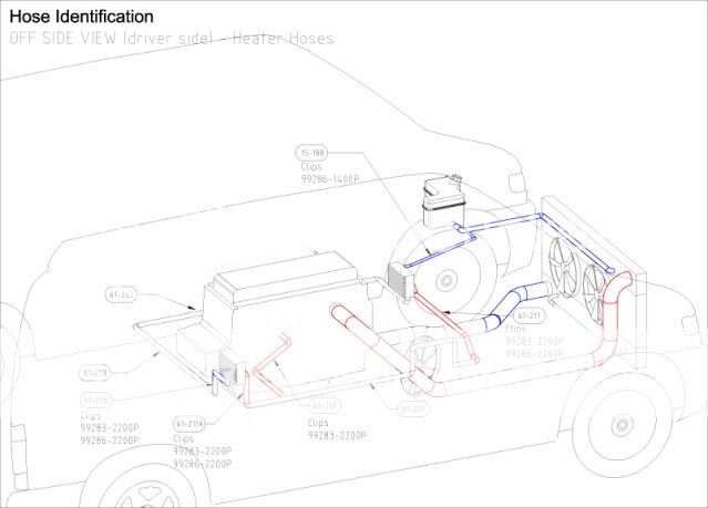

Main hoses - off side (driver)

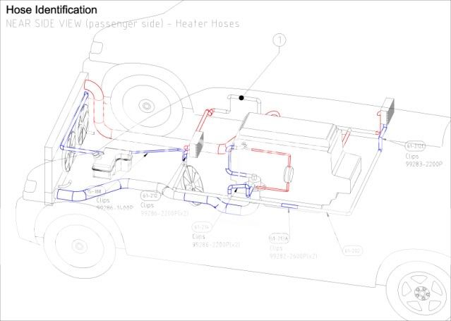

Heater hoses - near side (passenger)
Heater hoses - off side (driver)
Constructive critism welcomed.
Quality loses out through photobucket - sorry.mister munkey wrote:Great piece of work but kinda hard to see, a bit misty.
Should I go to Specsavers?
pm+email sentmuHATDNHAYDN!!!!!!!!!?nroman wrote:Hi Steve, thanks for all the work you are doing for fellow owners!
Firstly, could you make the drawings bigger for old eyes like mine! - I know it it most likely a forum thing, but it would be good to know that a factsheet was in A4 for example.The forum pics are as big as allowed. but the factsheet WILL be A4.
Secondly, for similar reasons, can you make the part numbers darker, black and bold for example?
Thirdly, and perhaps Haydn can help, would it be possible to give sizes for the hose clips, I am an exponent of using the OEM constant pressure clips, but for emergencies it would be good to have proper sized spares.HAYDN!!!!!!! - HELP
Keep up the good work, it is appreciated!

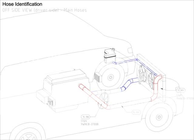

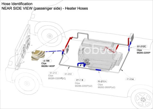

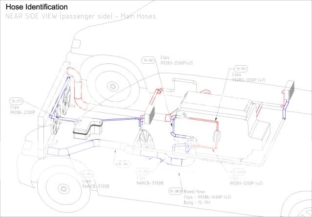

Following suggestions from munroman, mrmunkey, et al about clarity, this may be better.munroman wrote: Firstly, could you make the drawings bigger for old eyes like mine! Pics are as big as forum allows
factsheet was in A4 for example. Factsheet is A4
Secondly, for similar reasons, can you make the part numbers darker, black and bold for example?Done
Thirdly, and perhaps Haydn can help, would it be possible to give sizes for the hose clips, I am an exponent of using the OEM constant pressure clips, but for emergencies it would be good to have proper sized spares.Not heard back from Haydn yet
