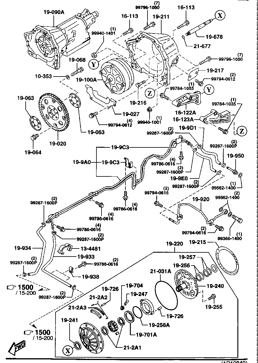

Hatris.........if they mean the driveplate for the torque convertor then that can be checked with the gearbox in place and therefore a decision could be made as to whether the fault is the driveplate or the gearbox,
Item number 19 - 217 in the lushprojects page http://www.lushprojects.com/bongopartsmk2/1R10841.gif is an inspection plate. When removed you can then access the torque convertor. If the torque convertor revolves by hand then the driveplate (number 19 - 020) is broken.

Hi dandywarhol, I wouldn't know, but wheelquick are bringing in a gearbox chap to sort it, which is why they only suggested finding out were we might lay our hands on a gearbox. Can you help with a question. When I rang partsplaza they asked for the year and if it was 4x4 and if it was a new shape bongo. Does this mean the one on ebay would not be suitable? Thank you for your help. Really apreciate it. Trishadandywarhol wrote:Hatris.........if they mean the driveplate for the torque convertor then that can be checked with the gearbox in place and therefore a decision could be made as to whether the fault is the driveplate or the gearbox,
