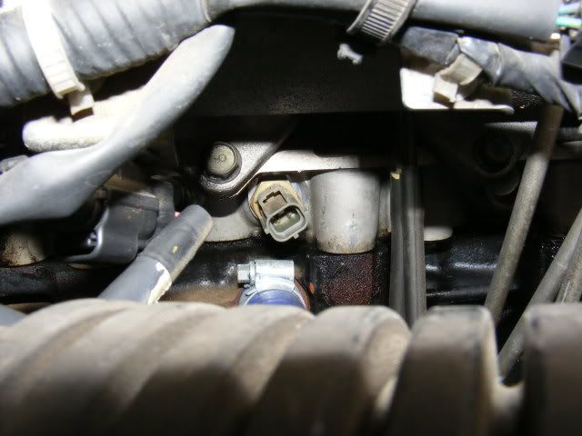

Position of the scavenger fan unit. just unplug to test if fans are working.its under the drivers seat
old unit
new unit ,yes you can buy them, i got mine from Wheelquick in Wigan.

Thats the radiator fan sensor DBO......is'nt it?
The scavanger fan sensor is by the handbrake, and if i remember right it works the same...... if the engines running and you disconnect the plug the scavenger fan starts, runs for a set time........it does on mine anyway.

Post by daveblueozzie » Mon Jul 20, 2009 8:33 pm
brorabongo wrote:Thats the radiator fan sensor DBO......is'nt it?
that's the sensor Mike at wheelquick said controls both fans, radiator and scavenger. my scavenger fan was not working,we changed this sensor and it is all ok now.
i cut one of the wires from this sensor and fitted a simple on/off switch so i can now turn the scavenger fan on when needed in extreme conditions.

Re: Scavenger Fans
Post by dandywarhol » Mon Jul 20, 2009 9:48 pm
The one pictured is for the radiator fans and also sends a signal to the ECU. This also controls the autogearbox changeup until the coolant is warm enough to allow the lockup to come in.
The scavenger fan control is next to the handbrake but is also linked to the ECU.
