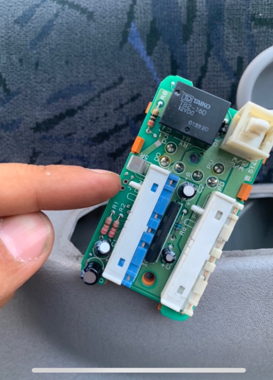

Nabil
Posts: 9
Joined: Fri Jul 03, 2020 8:56 am
Re: Electric window wiring
Post by Nabil » Wed Aug 12, 2020 8:12 am
I have a buzzing noise, when I place the sliders in various positions on the driver side. But the driver side switch doesn’t operate the driver window. The passenger ones operates both, baffled.
