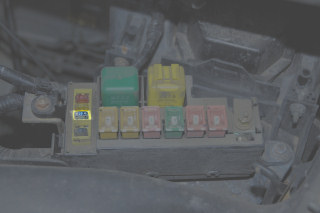

Most likely as Kirsty says above, the fuse for the Tail, Number and Sidelights is;
They are all powered via a relay from that fuse so its not going to be the Fuse or relay as all the other lights would have failed.
