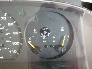

2. I'm thinking of putting the LED in the switch blank marked with the red arrow here:
That seems to be the usual spot, although the green arrowed blank would also be an option. Stick with the red?

Either of those 2 blanks will do as for the live feed the fuse box is just below so take it from one of the feeds there

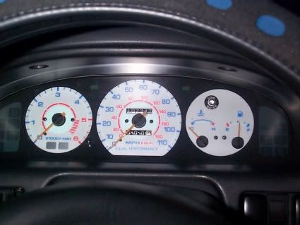

as for where you put the led, i fitted mine on the dials, there are spare holes behind the dials ,and a small drill soon sorts it out.
its fitted just above the temp guage

Or think about this way....all connections and the LED next to the temp gauge.
Whilst doing this it would be a very simple task to do the Temp gauge mod which will make the gauge actually work. See http://www.coolantalarm.co.uk free downloads
Don't be frighteded by the thought of removing the speedo dash.....takes about 10 mins extra and you really carn't mess anything up

Hi Haydn try this link and make sure you ask for the V6 dials as they are different I believe. :D
http://www.visual-performance.co.uk/

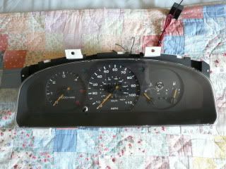

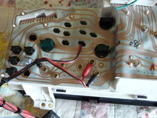

I actually used the live and negative feeds on the back of the binnacle, as shown in this one of Haydn's pics:
If I had a recommendation for the kit, I would include this in the instructions and supply a couple of these:
on the + and - wires to the unit perhaps. It does save cutting into the loom.

Sharkojoints wrote:Thanks guys - all fitted and working, I think.
I had a few pieces left:
I suppose the razor blade would have been handy if it had all got too much :wink: , but where should I have used the rest? #-o
O.K. First pulling out the cluster is perhaps not to everyone's liking. Also remember that we produce these kits for a whole range of vehicles (in fact any water cooled vehicle) We cannot cover every method for every vehicle...
So we now just say switched live and earth...a bit of research or a phone call will provide more detail.
The bits left over.....razor to clean any Flash off the tank before fitting the sensor screw,,,,(perhaps not required....I don't use it when I fit them.
The ring terminal to fit to the earth wire (We don't fit it for you in case you want to go your own way or shorten the wire....)
the male female spade......find a switched live wire.....cut it....put one bit along with the Alarm live into the blue one (big enough for 2 wires to crimp in)
the red crimp terminal to the other end bit of your cut wire.....plug together and BINGO....job done....Nobody has ever asked what they are for.....

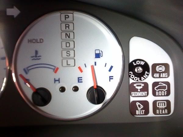

Alternative location for the LCA on the newer shape, didnt even think about wiring the +/- to the clocks #-o , thats a nice easy idea if your fitting the led into it =D>
The white dials for the newer model has two 'HOLD' light masks, this tidies it up nicely
