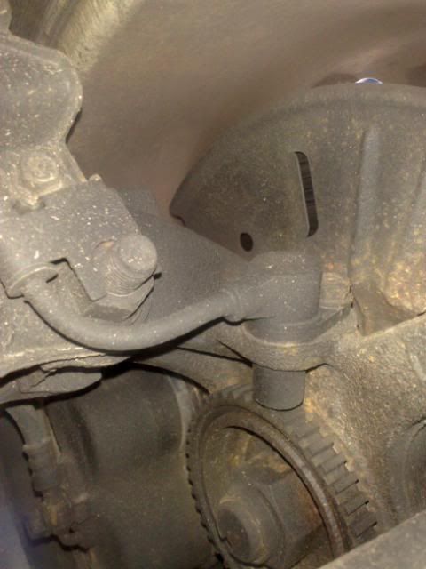

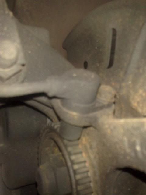

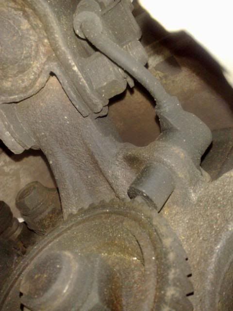

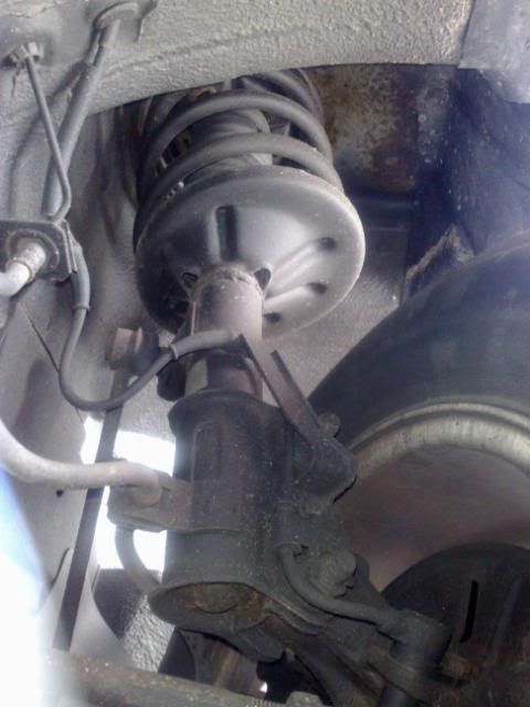

as promised, pics of abs sensor and wire route/brackets.
this is a (p) reg 2 wheel drive.
Ady
Ady

Brilliant - that's exactly what I needed as mine are most definitely not like that - I assumed the reluctor ring was enclosed within the hub but apparently not! Time for a phone call!
cheers!
Steve
