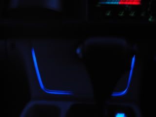

When the side lights are on the dash lights up & so do the switches...
maviczap wrote:After succussfully fitting my MPH speedo facia and coolant alarm to my Bongo, I wanted to know what the function of the 4 pin socket behind the blank switch on the dash
On the left there's the rear window heater switch, I know what thats for
But on the right hand side is a 4 pin socket with red and black wires. 4 in total.
It must plug into to an additional switch, is it for the front fog light switch?
& so does one of the wires on this baby... The other one goes to ground... I used the spare connector to power some additional lighting on my dash... :wink:
... At least i think that's what i used it for..?!! :? :lol:
