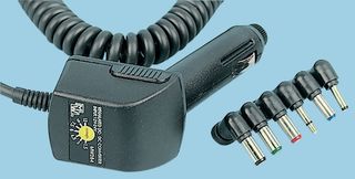

Hmmm... something like this? http://www.rapidonline.com/sku/Electron ... 55/47-3302g8dhe wrote:I use a 5V 2Amp regulator pushed up behind the cabin light, and pick off the 12 volt unswitched power feed from the cabin spot lights feed;
Re: Hard-wiring a TomTom One
Yes if your happy adding the required decoupling capacitors etc, I actually used one of these and cut off the cigar lighter extension and just replaced it with a couple of wires to reach the Blue/red and black wires on the plug for the lights.
a slight adjustment to the 4.5 Voltage divider or add a series diode on the output and select 6Volts will do the trick, the TomTom 910 we have is much happier when run from 5.1-5.2 volts than from 5 volts. I think there still available from CPC http://cpc.farnell.com/_/mw284/dc-dc-co ... tt=PW01832 yes but they have gone up in price since I bought my pair!
