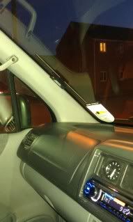

bongomac
Re: How to fit an aerial?
Post by bongomac » Wed Mar 09, 2011 12:46 pm
Nice one guys- I'll give it a go over the next couple of days. Good tip by using the sun visor by the way-cheers.
However if it doesn't work i'll be interested in what you discover bongodonkey...
bongomac
Post by bongomac » Thu Mar 10, 2011 10:27 am
Here's some pics of ours, as per previous request:
