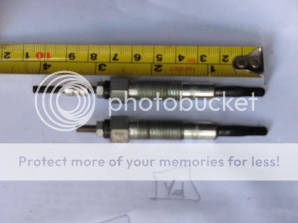

Re: Glow plugs
I don't know where to get them, but you can buy extensions as were on mine:
Re: Glow plugs
tallbongo wrote:I don't know where to get them, but you can buy extensions as were on mine:
Hi,
To do the same as you have.
You just need the screw tops from spark plugs and a pieces of threaded set screws.
Cheers..
