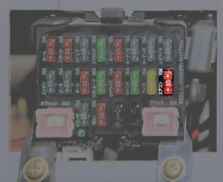

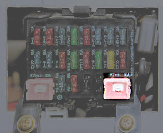

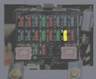

2. Identify the two wires that go to the coil - connections 85 and 86, one will go to Earth/chassis the other will go to what is termed the IG2 circuit from the Ignition switch, it should go to one of the fuses fed by the IG2 circuit - my choice would be this fuse;
and it would pickup the lower fuse connection (Green wire) or you could pick it up on relay I1-01 under the bonnet;
- but it could also go to 3 other possible fuses;
If it isn't one of the above then its on the wrong circuit and needs to be re-wired. See if you can identify where it goes and feedback here and we will try to help.
