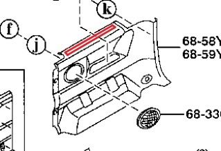

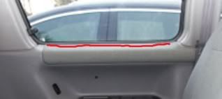

It's not on the LP diagram, so i put one in!
It kind of pads the window ledge from underneath between the trim & the inner shell where it kind of bevels away from the window seal, so the trim sits flush with the window rubber at the bottom....
Highlighted in red it goes here... About 10mm from the leading edge of the panel where it buts up to the window ledge..
I re-glued mine using tiger seal type stuff... (sticky pads don't cut it.) It will slip again if you try to re-stick it with the existing failed bonding on the foam/rubber! (They are on all three trim panels.)
.... If that's the piece you mean??!

Just to elaborate... If you find the leading edge has dropped a bit skew & don't seem to sit straight with the window, with give in the middle when squeezed down?
Chances are the pads slipped!??

Brilliant, I can build it back up now. It turns out that all of my pads had slipped down so all the trims appeared saggy. Thanks alot for the quick replies everyone.
