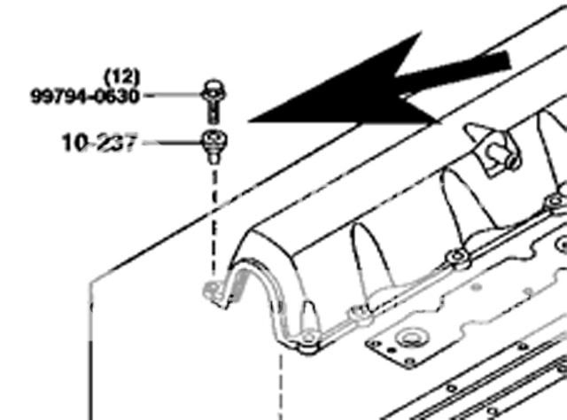

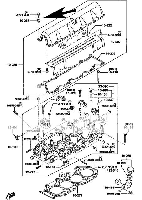

If the "special nuts and bolts" you refer to are for the rocker cover, there are bolts and 'top hat' shaped spacers that hold the cover down. Neither need to be replaced.
Repeat - If you are just changing the rocker cover gasket, then all you will need is a new gasket, spanner (or socket) for the bolts, and about an hour (maximum) of your time.
There are 12 bolts in all.
Arrow points to bolts and 'top hat' shaped spacers
