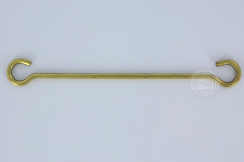

Expanding on the idea....
Seen this on a plumbing website... But an arrangement like this...?
Edit; just been out & looked at my manual set up... The white cog is exactly the same, but that retainer tab though intact is redundant on mine on account of a cable attached to a nipple driving it on the left....
