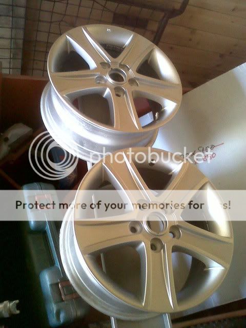

hi, ive just bought some mazda 6's which mike at wheelquick assured me will be fine and just saving the pennies now for tyres - 215-60-16's or 215-65-16's
theyre in the process of being refurbished at the moment, cant wait to get them on
