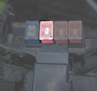

You can check the 30 Amp HEAD fuse;
This supplies the Field coil with power and also the headlights!

Checked the head fuse and it appears to be fine - I can get a resistance across it.
