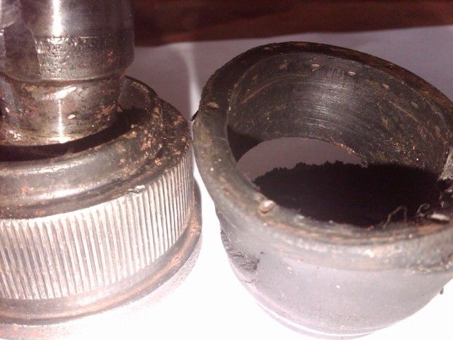

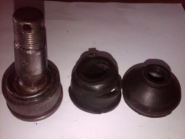

Here is a list of the sizes required for Rubber Boots for the items shown below.
Front Suspension Wishbone Ball Joint and Rubber.
Size of Ball Joint bottom seal, 35mm. Top seal 22mm.

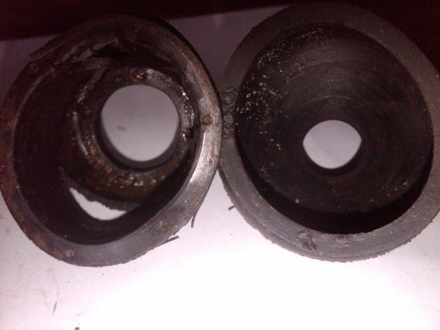

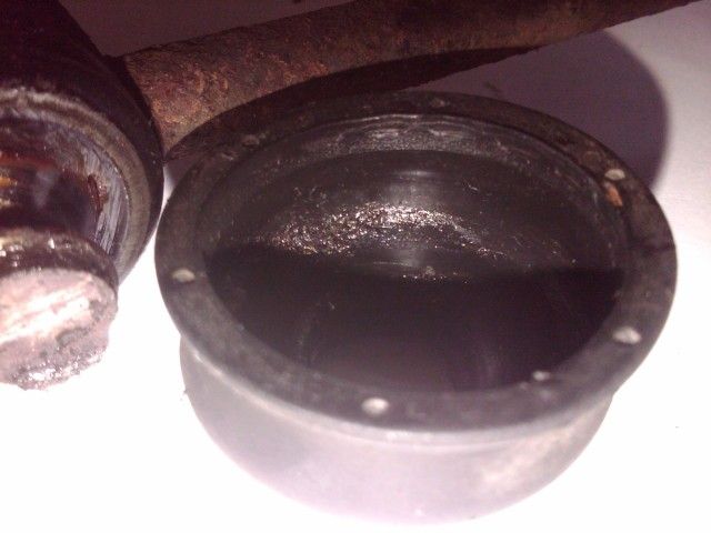

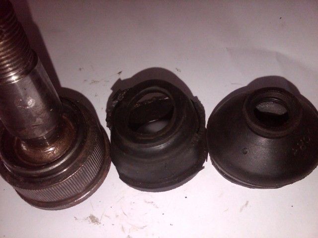

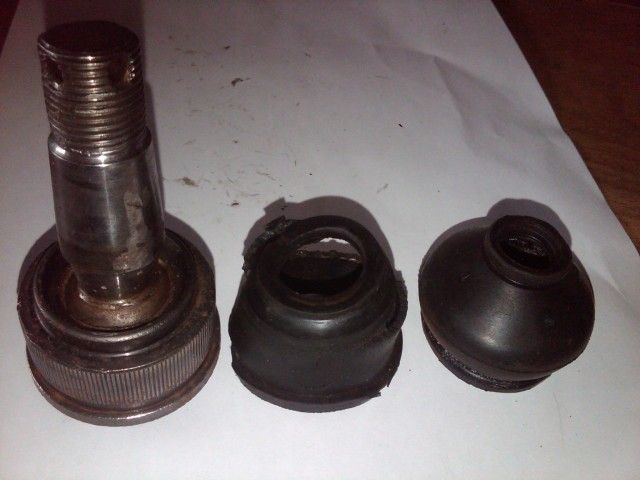

The left rubber in the picture is a genuine rubber. The one on the right is a cheap replacement part that fits
but quite badly. The upper hole is to small and the lower hole is slightly baggy. (See reference below to metal ring clamp)
The Photo below shows the gripping metal band that is part of the rubber boot. This grips the seat of the ball joint
and holds it in place. The replacements do not have this, so may let water in and grease out.

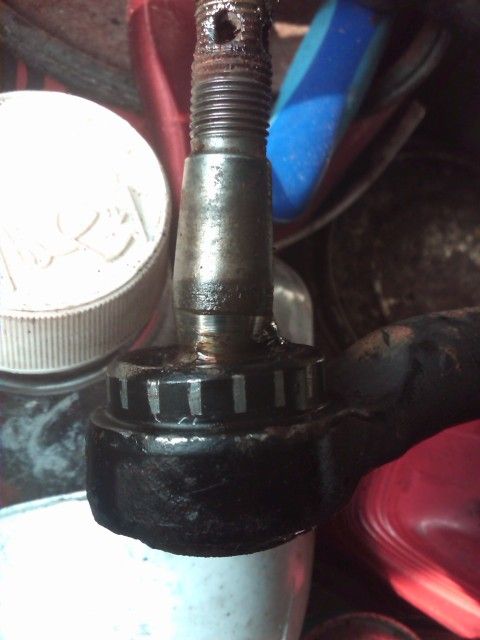

Front Droplink
Large side 30mm - Small side 14mm again, note the rubber contains the metal band that grips the droplink.
Steering Rack Track Rod End
Small hole side 15mm - Large hole side 32mm. Again with metal clamping band on large hole side that grips the ball joint.
