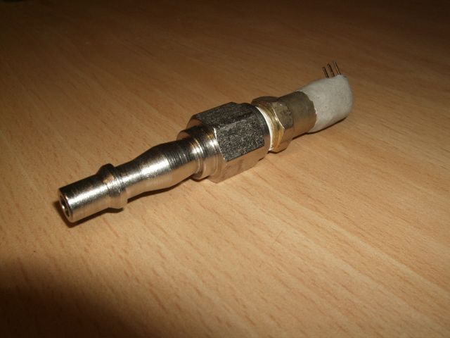

Re: Coolant pressure sensor
Here's the sensor assembly:
I used the super putty stuff to embed the sensor in the top and then wrapped it up. 10 minutes later I hooked it up to the bike pump and voltmeter and got it up to just over 2bar, reading 3.something Volts and held pressure for over a minute. Good enough for now, and it hasn't even hardened fully, yet.

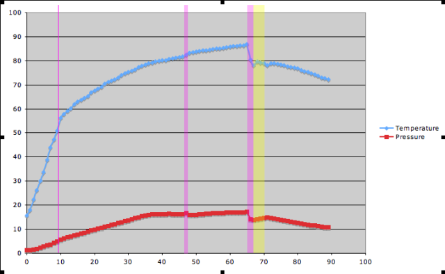

Time: 1h30
Diesel: unknown
Whisky: unknown
First pink line is when the cold-start cut off.
Second pink was 1 minute at 2k rpm
Third pink was full/hot heaters plus A/C for 2 minutes
Yellow was full/hot heaters with no aircon for 3 minutes.
Then I switched the engine off.
No wetness from the header tank overflow.
Several things I can't explain on these graphs. At 36m, why does pressure stabilise but temperature continue to increase (I thought I'd hit cap pressure)? But then, why do I see another 0.9psi on top of that a bit later? I need a view on pressure in header tank. I need temp gauge on bottom hose.
Edit: I happened to do the 1min@2K RPM right around the time the thermostat opened.
I've proven it works, I'm drunk and I'd do things differently on the next test run.
Edit: the fact I'm nudging 16psi all the while is enough to convince me of a gasket/head fault.
Diesel: unknown
Whisky: unknown
- Northern Bongolow
- Posts: 7724
- Location: AKA Vanessa
very very very very good mate.
takes things nicely on a big jump.
re your question at 36 mins. look closely at the system temps that will give you your answer.
if you had your temp probe inside the stat housing the results would mean more.
if you had a head problem the pressure would not drop when the heaters were put on, so the answer to your pressure problem is temp related, so !!!.
Forgot to account for the offset voltage indicating 1.25psi at the sensor at rest (cap off) due to the head of coolant above it.
The max (adjusted) pressure seen by the sensor at 65minutes into the test was.......
1.096 bar!
So chances are, before I put the aircon on, had I waited another couple of minutes, I would have heard the cap vent.
1.096 bar!
I bet you're going to say "put in a genuine thermostat"? I still can't quite come round to your thinking.Northern Bongolow wrote:very very very very good mate.
Give me a week or two to get this sensor logging data so that I'm not using notepad and pencil once a minute and I'll give anything a go. I can just about afford the diesel, but I can't afford the whisky!
Edit: this morning, temp 17.2 degC, resting pressure +0.75psi.
