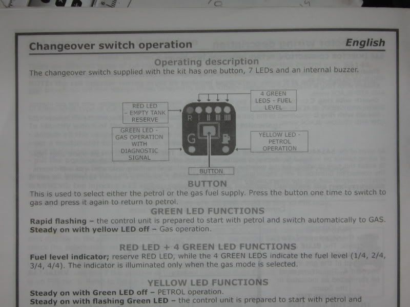

fatboysim
Re: V6 Stalling regularly LPG Problem?
Hi thanks for all the feedback, sounds like the next thing I need to do is to contact the company that did the conversion as we will have done 1000miles easy. We have taken it back there once already but sounds like needs to happen again.
I cant identify whether it is gas or petrol problem as it switches automatically and I have no idea when this happens, no way of feeling this.
Anyhow thanks, I have a feeling I will be back on here though!!!
- mikeWalsall
- Posts: 3075
When the engine is up to normal running temperature, with most systems it is easy to manually switch from gas to petrol and visa versa ..
Just press the white square button in the centre of the LPG contents leds ...
See if the symptoms disappear when running on petrol .. then reappear when you press in the button and revert back to LPG ...
