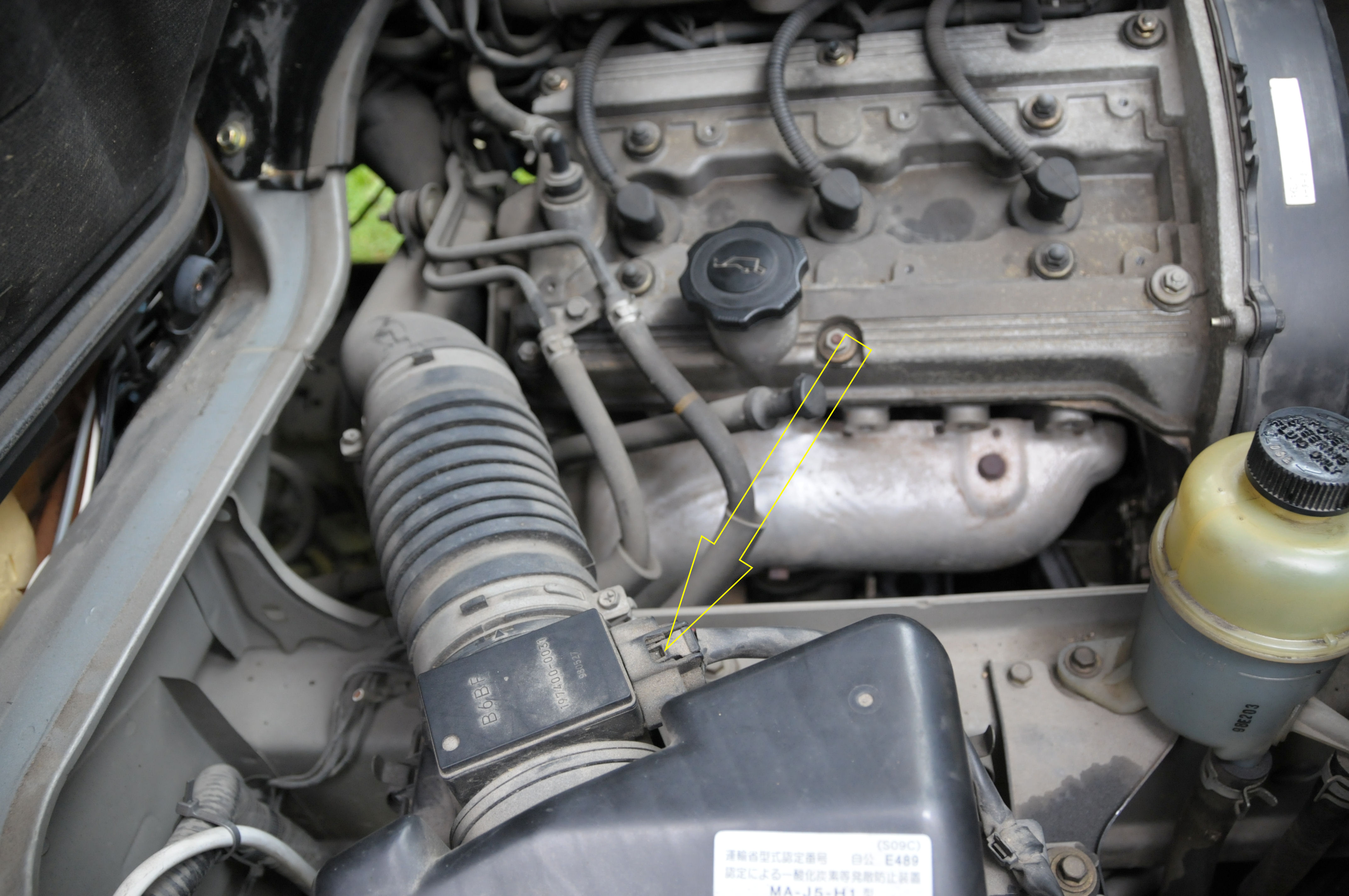

I would guess you're referring to the MAF sensor on a petrol Bongo. As I recall, you just squeeze the plug in the relevant direction and it should pull off.

Press the little catch down arrowed in the picture, click for large scale version;
