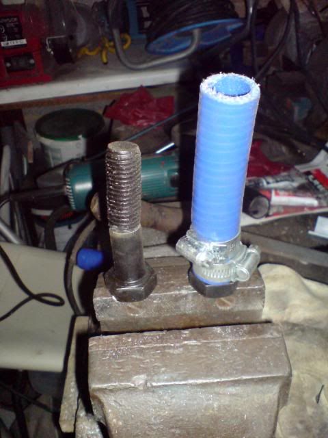

Rear heater & AC is finally out :D Hoses blanked at the points I thought they could be by using the short length of hose under the passenger seat at the rear going towards the rear heater, cut in half, two 18mm bolts with unthreaded sections at the top, modified to make 2 plugs held in place with the existing clips from the hoses removed.

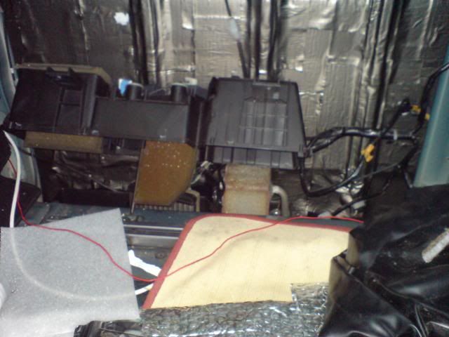

Fan already out, cover unclipped, revealing ac evaporator & heater matrix

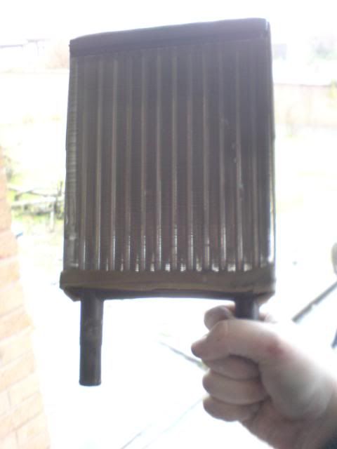

Heater matrix out

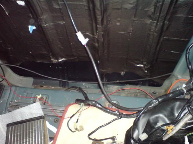

Empty well

Making coolant blanking ends from 18mm bolts cut down & filed off to round edges
Heater supply coolant blank in situ just infront of rear heater under drivers side
