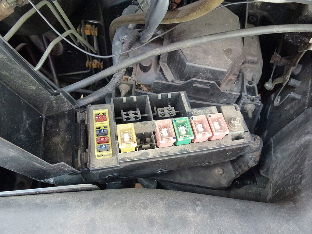

Missing both ABS fuses and the Main.

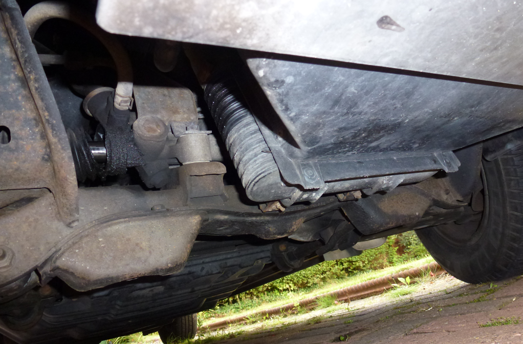

noticed 2 problems underneath :/

Ain't no exciter rings so don't look like its abs .steering rack boots burst ,easily replaced and not too expensive

Oil getting out from that boot? and onto the air con radiator?
Am i missing the main fuse then? And what does that one do?

the oil on the intercooler may just need the clip above tightening up, or remove the intercooler altogether then wash out any collected oil thats in there.
the steering rack maybe leaking from the seal where the shaft comes down into the rack and running down, lift the rubber seal (top hat shaped) around the shaft to check.

If you do not have the ABS fuse .. pump / valve block .. the toothed cog / wheel sensers .. then you do not have ABS fitted ..

It doesn't have ABS , but it does have serious PS steering rack problems. When is the MOTT due.

The damp patch behind the brake caliper needs checking out too.
