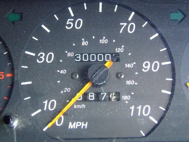

Hi all, sorry my first post is a question. I've owned my Bongo for about 6 months, and am aware that speedos often are not reading correctly. Mine has an MPH face but the true figures are way out (as checked by both satnav and driving alongside my wife's car).
At 70mph (true) the speedo dial is at almost 12 o'clock, whereas all other dials i've seen it's at 1 o'clock. My tyres are brand new 195/70/R15C.
Is it possible to get a replacement speedometer face that matches my true speeds.
Also I presume my 'mileage' is incorrect as well.
Picture of my speedo and markings:

Ours has the 60 mph at 12 o'clock and reads pretty well spot-on....
If you're running 195/70 all round, that won't affect the speedo reading but you should be running 215/65 on the rear, look at the sizes quoted on your driver's door-pillar or in the handbook. Your insurance may back out of a claim if they can state you were running non-standard or undersized tyres :wink:

Every other Bongo I've seen has 60mph at 12 o'clock, but mine is a true 70 at that point. What's causing it? Any ideas? (the markings i've put on my speedo are all double checked with Sat Nav and wife's car.)

My speedo shows 60mph half way between 12 and 1 oclock.
I recalibtated mine by moving the dial to show an indicated 30 @ a measured 30 mph
the indicated 70 mph gives a measured 65 +-1.
My tyres are 215/65/15 all around on a 97 4x4.
http://igmaynard.co.uk/bongo/forum/view ... =3&t=65825
http://www.igmaynard.co.uk/bongo/forum/ ... 73#p405273

Dans - You could pull the needle off the speedo and replace it in an accurate position. I did this when I changed the dial and removed the chip that converted kmh to mph (which I would suggest you do as the gearbox worked much better following - it decides when to change based on the speed)
It's not too bad a task and involves driving around with a sat nav and the clear plastic cover off the dials, repositioning the needle lightly until you get it just right / over reading a little.

I had exactly the same issue with mine I cured it by taking the needle off and re-fitting it in a slightly different position what I found on mine is when you turn the ignition on the needle will move up slightly I set the needle to line up with the small line just past the 0 MPH mark when the ignition was on and now its pretty much spot on if you do this there are two small counter balance weights in the back of the needle that will fall out so you have to be carefull taking it off I used a bit of super glue to hold these in as it can be hard to get them to stay in place when refitting you should find your mileage reading is accurate irrelevant of what the speedo is reading unless you genuinely have a duff speedo
