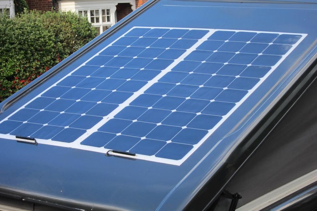

Oh, for the drool factor, here is the 240w VW installation :-)
http://www.solarcampersolutions.co.uk Solar panel solutions for campervans
