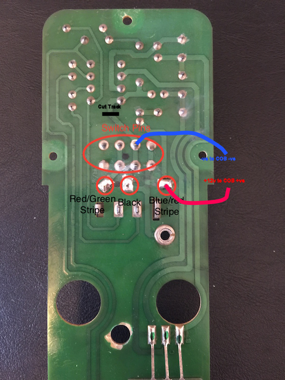

Post by Gdlee1976 » Thu Jan 21, 2016 9:00 pm
Gdlee1976 wrote:
g8dhe wrote:Yes, but the wiring is a little different, I don't have an old style board to take photo's of so can't show you what needs to be done in as much detail.
Here's a picture of the connection on the old style (straight tube) board Geoff... I do not have a tester so I'm not sure what each wire is what.
1 - Red with green stripe.
1 - Black wire.
1 - Blue with red stripe.
My COB panels have a red (+) and a black (-) wire each.

Post by g8dhe » Thu Jan 21, 2016 10:17 pm
Really need to see the whole board to suggest the best pick up points as the switch is connected to the board directly, the picture above only shows the external connections. The aim is to pickup the +12 volts which comes in directly from the Blue/Red wire above and connect to the +ve of the COB board, then locate the common connection of the switch, lift it from the old board and connect it to the -ve of the COB board. That way you isolate the existing electronics but leave it very simple to reconnect in the future if necessary.

Post by Gdlee1976 » Fri Jan 22, 2016 1:32 pm
g8dhe wrote:Really need to see the whole board to suggest the best pick up points as the switch is connected to the board directly, the picture above only shows the external connections. The aim is to pickup the +12 volts which comes in directly from the Blue/Red wire above and connect to the +ve of the COB board, then locate the common connection of the switch, lift it from the old board and connect it to the -ve of the COB board. That way you isolate the existing electronics but leave it very simple to reconnect in the future if necessary.
Ok, here's what I have figured out so far Geoff...
I think I have the door position figured out. Red from COB to Blue/Red on board, Black from COB to Red/Green on the board.
Reverse side with switch showing.

Post by g8dhe » Fri Jan 22, 2016 2:49 pm
Not as simple as that, the Red/Green wire is the door switched Earth, so if you use that it will operate with the door at all times, and the rest of the electronics will remain powered up and drawing current.
You would need to cut the track on the PCB that leads and pickup the switched earth -ve connection as below - but can't give a complete guarantee without inspecting it myself!

Post by Rocketscientist123 » Tue Feb 16, 2016 9:58 pm
hi all,
I tried replacing the fluoro tube in the interior light with a straight swap for a T5 224mm LED tube that i bought on Amazon. This didn't work. The very nice man (Nick) at LED-zip.co.uk in Bournemouth was able to suss out the wiring of the PCB in the interior light fitting (which corresponds to the advice above in the thread, and the required track cutting), and splice in 3 lengths of LED strip. it's now very bright, and good enough to read by......the missus is happy.......
