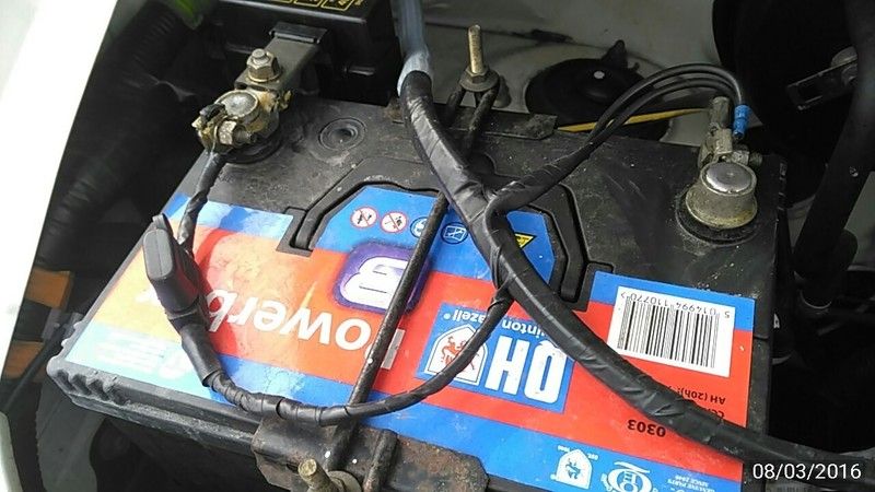

I checked as many fuses as I could find using a meter. All the ones below right of the steering wheel work fine. All the ones in the kit work fine. In the engine I found two fuses coming off the positive terminal of the leisure battery and the yellow 20A had blown. Replaced that and that seems to have made no difference to anything.

fuses coming from positive terminal of leisure battery
cable from leisure battery crossing over main battery - with some cables joining from the main battery?

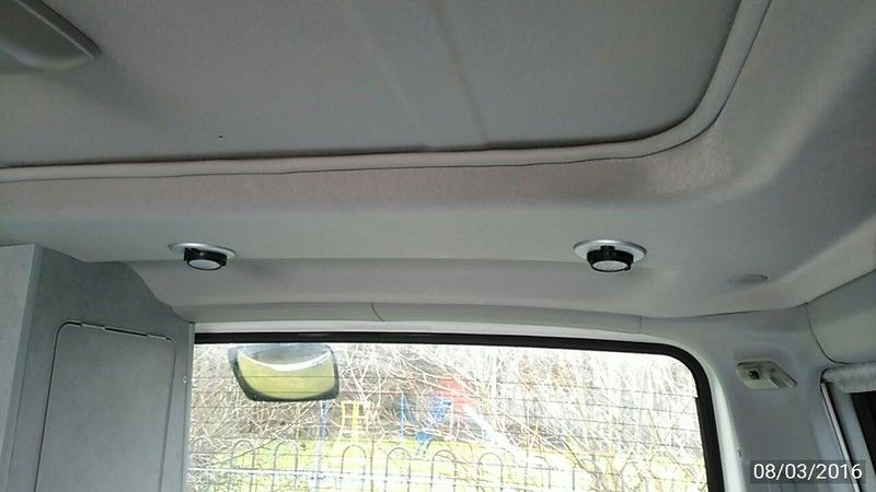

the lights that don't work are the led's in the roof

The two in-line fuses handle the Split Charge Relay and charging of the leisure battery, if either of these fails then you MUST replace BOTH fuses as whilst one will have blown the other will be damaged and with these not working then you won't be charging the leisure battery at all from the alternator.

g8dhe wrote:The two in-line fuses handle the Split Charge Relay and charging of the leisure battery, if either of these fails then you MUST replace BOTH fuses as whilst one will have blown the other will be damaged and with these not working then you won't be charging the leisure battery at all from the alternator.
Thank you, will go and replace both now. I did wonder whether I had a split charge already set up but being so new to all this I wasn't sure.
