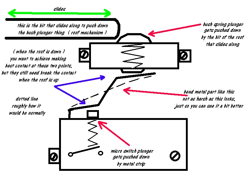

As to not stopping on the way down, not heard of that before, but the stopping is triggered by a switch mounted on the nearside upper runner, so its possible that isn't being triggered in some way - not being pushed in or permanently operate.
The switch works as shown below;
and is mounted here;
