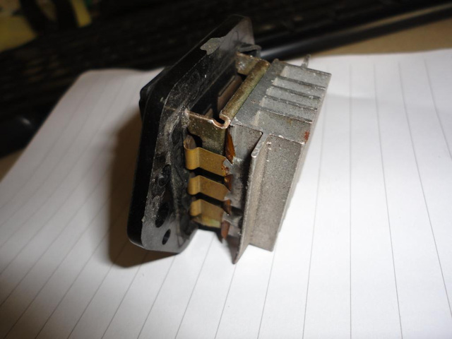

The Fan inside the covers is for the front air con, that should be controlled by the Air Con controls, however they do have a habit of overloading due to corrosion of that fans bearings in which case they either blow the control transistor with the electronic Climate Control version (check by setting it on max speed if it works then, then the transistor is blown and can be replaced), or if the older slider style controls then the thermal fuses pop on the speed control resistors and they need soldering back down.

The thermal fuses are quite do able they sit here where the probes are;
The resistors when repaired will look like this;
