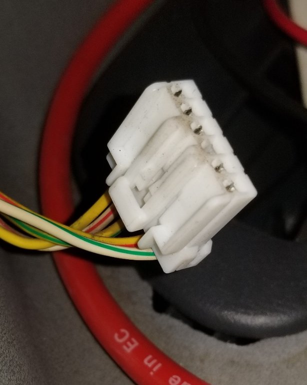

Rather than bodging wires in connectors, it would be wise to use the original connector instead, with an extension of course.
Is it possible to have a picture of the original connector? I may possibly have them here, all the blind wiring was taken from the loom as there is no electric blinds in mine.

Just found them, the wires are approx 2 foot long, there are five of them, if these cound be spliced in, then it may solve the problem.
I have a box of scrap stuff awaiting disposal, if anyone can make use of it.
Rickster
Posts: 66
Re: Extending the rear blind switches
Post by Rickster » Tue Aug 04, 2020 4:00 pm
Correction, 1 is a fit long, the other looks to be about 2 foot.
These are pretty much as seen in the below pic, please excuse the white wash, the phone insisted on using the flash.
