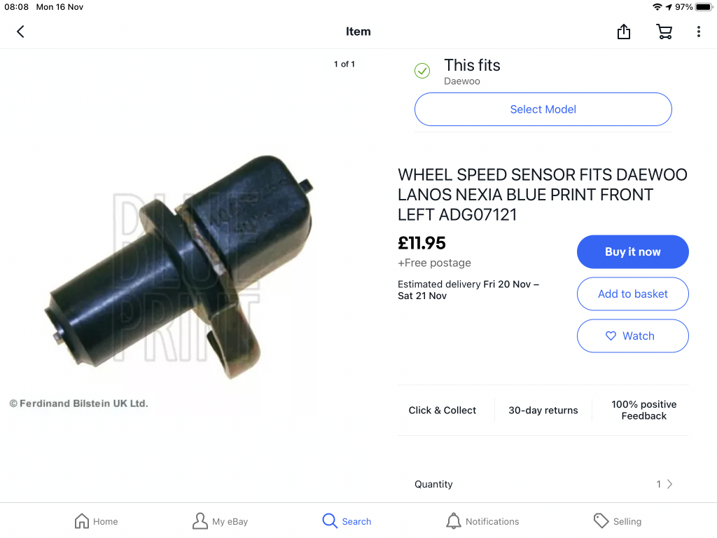

Just a couple of other points to be aware of,
1. It would appear that the sensor is coming from Germany, hence the £8 delivery, and has quite a lengthy delivery time (thanks COVID
2. My sensor was very tight to get back in, I had to use a bit of persuasion by tapping gently with a hammer and blunt instrument on the metal fixing bracket of the sensor and a thin film of grease around the sensor body.
3. I had to drill out the sensor fixing bracket hole with an 8mm drill to get the original fixing bolt through.
A bit of a pest but well worth it for the circa £150 saving.
