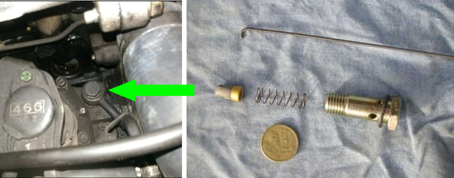

Post by g8dhe » Mon Aug 17, 2020 9:07 pm
How about the Banjo filter being blocked ?

Post by Tomd » Mon Aug 17, 2020 9:46 pm
Hi Geoff,
Thanks for the reply and pic, after reading up on the forum that was one of the things I was going to look at.
It seemed odd that when the RAC man used a hand held bulb pump attached in the fuel line to draw diesel from the tank and push it through to the pump the engine revved perfectly.
