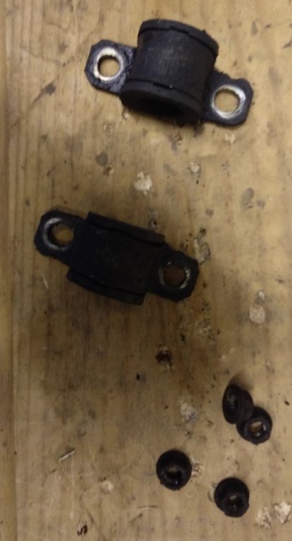

Post by sotal » Thu Aug 20, 2020 3:57 pm
Well that was easy enough in the end, all four nuts removed easily.
Is it standard procedure to reuse the old nuts. They look ok.

Post by sotal » Thu Aug 20, 2020 3:59 pm
Bits removed...

Post by Northern Bongolow » Thu Aug 20, 2020 8:31 pm
It must be one of those rare cared for none rusty underneath bongo,s.
It must be worth 2 k more than the others.lol.🤭
