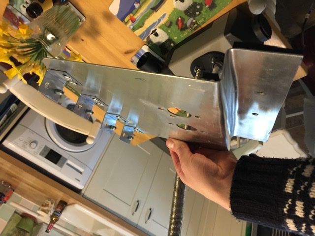

I made a bracket out of 1.5mm aluminium
Fitted heater under passenger seat
I used a t-piece to pick up fuel under drivers seat (there is some talk that this could dry up the seal on the actual fuel pump i think so standpipe could be better into tank but I didn’t have any issues)
Fuel pump mounted on chassis rail under drivers seat, heat out behind center console (no space in mine in rear step due to lighting) and cabin air in passenger footwell. One thing to make sure of is that wiring it up to scratch in terms of thickness, I ran from fuse box in conversion which means a reasonably long run and heater kept detecting low voltage, cut earth from loom to shorten and upgraded to 6mm cable solved issue.
My install was for a Webasto airdrop stc2000 not one of the Chinese ones. Whatever you install would recommended rubber shock mounts for fuel pump and silencers on combustion intake and exhaust. I had to heat shield my air out ducting as it was very close the exhaust manifold
Have the bracket that could help as a template going spare as I sold the van and bought a v6. The v6 has no room for diesel heater in that location, managed to get a tank in it so far but still trying to find the ideal location for heater
