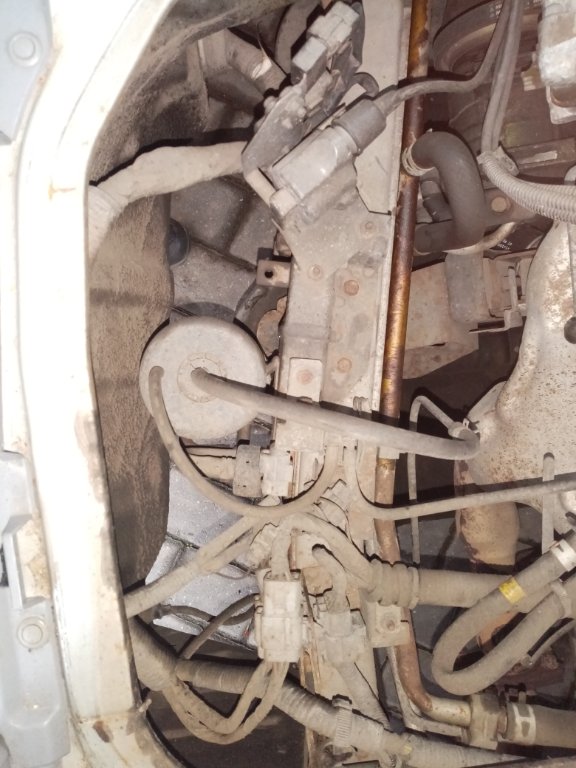

Im looking to fit a diesel heater under the front passenger seat in my 1999 v6 i have looked at the members fact sheet for newshape vehicles but this is for a diesel i seem to have quite a lot of electrical wiring where you normally fit the heater can this just be moved or is it not possible to fit hete on v6 hopefully attached pic
Posts: 10917
Re: Fitting diesel heater in v6
Post by g8dhe » Thu Dec 03, 2020 5:36 pm
Most people just move the items inboard of the supports I gather see here for various pictures for both 2l and V6 http://www.g8dhe.net/bongo_images/Heate ... ol_bongos/

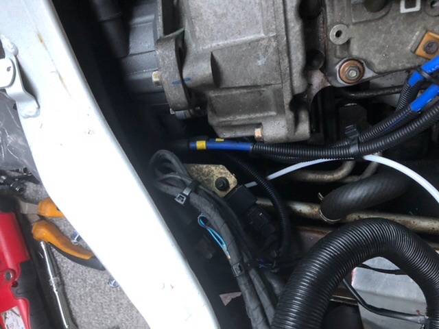

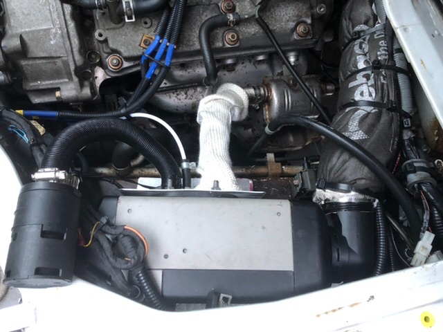

Moved ignition coil as far forward as I could, egr tank as far backwards as possible and wiring a bit. Egr tank needed slightly longer hoses I used standard fuel pipe. If you’re routing your ducting to sliding door I reckon you can just move the tank
