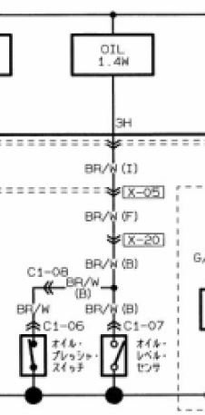

Your aware that the light is driven both by the Pressure and the Level switches ?
Might be worth checking both of them the other possibility is an earth on the signal wire back to the dashboard ofcourse.

Yes was aware there was the level switch in line as well. was not sure if there is away to test it other than replace it.?
With the signal wire i take it i can disconnect from pressure switch and drive with a DVM testing continutity against ground. to see if it grounds out ?
then can replace cable, or try find the break.

Indeed, the light coming on itself with both sensors disconnected would prove that alone. Use a meter to monitor one of the sensor switches to see if it closes once your running then it would point out which sensor is operating or if there is a fault on the wire.

I unplugged both sensors and the Oil light didn’t even come up with the Test at the start,
I plugged in the pressure sensor again and the oil light did the test at start up.
I left the level switch unplugged, and drove it around. And the light did not come back on!
So am I right in thinking that the switch if oil is low would then connect the cable to ground causing the light to come on?
So if it’s not on now it’s likely to be the level switch?
The connector is actually full of oil, seems there is a leak above it some where so maybe the oil in the connector can cause fault grounding?

Yes the level switch should make when the oil level falls to low .... you have checked the oil level ..... ?
