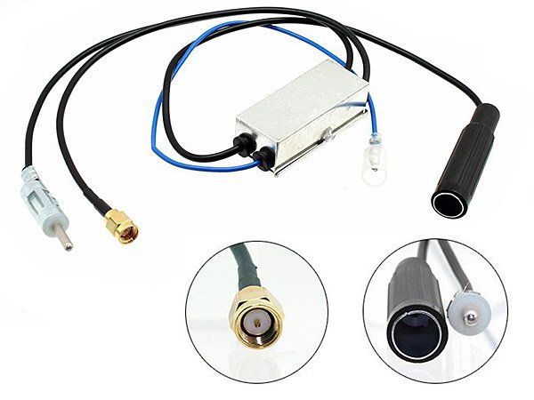

Has the van still got it's original aerial? If so, why not use an aerial converter box? It has a single socket input with 2 outputs, analog & digital respectively, the other wire is connected to the antenna power from the radio, reception is very good on DAB even with the aerial down.
Don't even bother going down any other road, glass mount contraptions are only manufactured to make the masses spend some money and nothing more.
In case you're wondering how much this magic box costs, it's only15 quid.

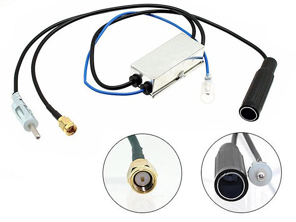

This is the thing I was talking about.

Unfortunately the aerial was removed when the can was converted.
