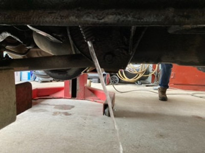

Post by JackLivock86 » Fri May 21, 2021 9:28 am
Hi Bob,
By way of an update, we had the Bongo up on a lift and managed to fix the issue!
As you had suggested, the waste pipe had come loose and managed to work its way up into the sill.
A bit of 'fishing' with some surgery pliers (!) and we managed to pull it back into place and fix it there.
Thank you for your suggestions!

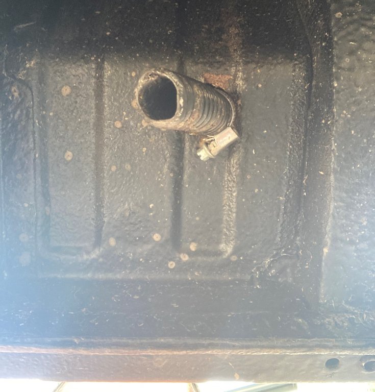

JackLivock86
Posts: 9
Joined: Tue May 18, 2021 3:47 pm
Re: Waste Water from the Sill
Post by JackLivock86 » Mon Jun 28, 2021 10:55 am

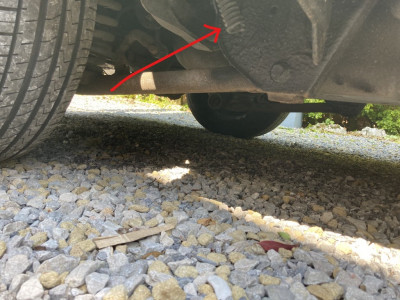

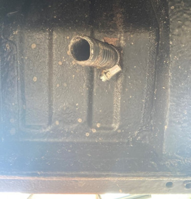

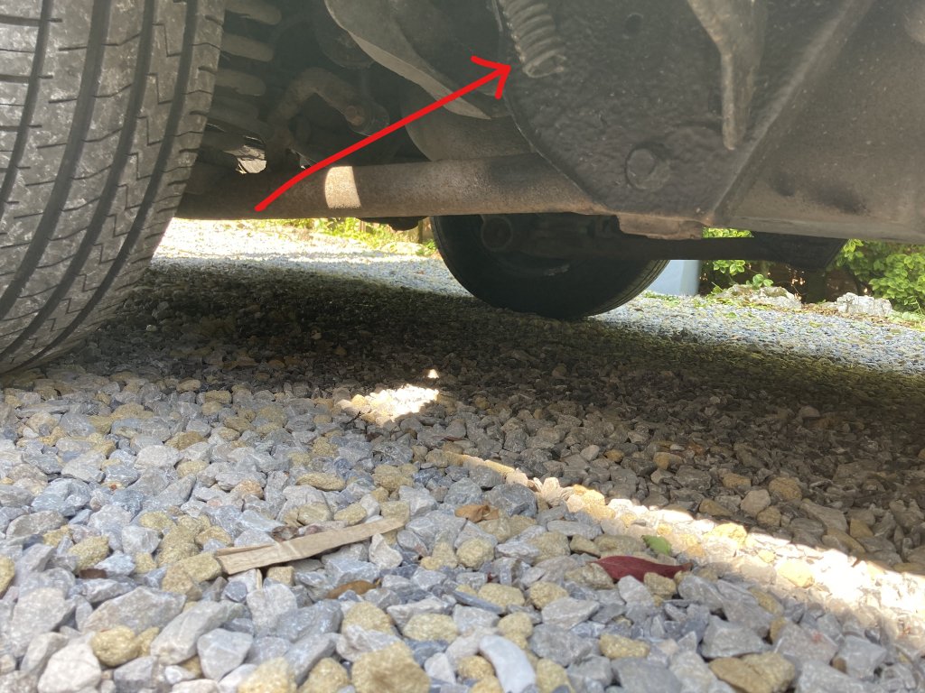

Hi Neil,
The waste pipe that had disappeared up into the body work was situated just in front of the driver's side rear wheel.
I'll attach some photos, but it is a little difficult to discern.
If you can get underneath your Bongo and shine a torch in any holes that look like they would accommodate the waste pipe (roughly 3/4 inch in my case) then hopefully you can find it hiding!
Hope that helps!
JackLivock86
Posts: 9

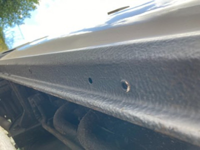

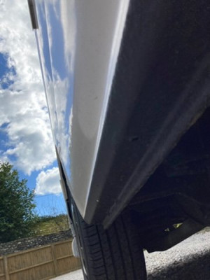

Post by JackLivock86 » Mon Jun 28, 2021 10:57 am
Some more photos...
JackLivock86
Posts: 9
Post by JackLivock86 » Mon Jun 28, 2021 11:00 am
Photos...
NeilW
Posts: 15
Joined: Thu Jun 24, 2021 7:52 am
Post by NeilW » Mon Jun 28, 2021 12:00 pm
ohhh nice one, than you very much for teh photos! Found it now..mine looks slightly different but have confirmed where it is :-)
Thank you very much again,
Neil
