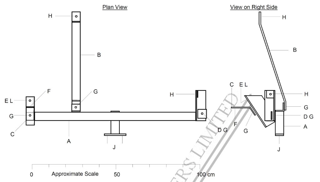

https://www.watling-towbars.co.uk/ They appear to do one for the Mazda range even if they refer to it as an MPV the VIN numbers match the Bongo's.

Humm, not convinced that the Watling design has taken on board the need for a nearside support to the main chassis rather then attaching to the angled plate that is spot welded on the nearside alone
