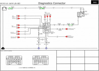

I have a flashing hold light when turning the ignition on but not while driving. It's a simple one flash on and off repeating.
It seems I do not have a live feed to the diagnostic box. I have no voltage when connecting the D (positive) and E (ground) terminals. Should that read 12v with the ignition on? What's the best way to fault find for this?

Are you sure your selecting the right pins, the box is mounted upside down compared to the other vehicles which is where the diagrams come from. The error code flashes won't start until you put the links in place, prior to that its just the on/off flash.
http://www.philmcfadden.co.uk/MazdaDiagnosticBox.htm The fuse is the far left 15Amp Blue middle row, which also supplies lots of other circuits around the engine itself.

I have tried a combination of wires; an led with a resistor and without, a paperclip jumper and an electronics kit jumper wire. I am not getting any flash, with or without ignition.
The hold light on the dash still flashes on and off in ignition position, but not while engine running. I wonder if this is a fault notice in itself, of the diagnosis port?

Make sure you have the LED connected the right way around, they are polarity sensitive or use a low wattage filament lamp!
Just a thought you don't have a flat LB do you ? The most common error is loss of backup supply, this will mean it spots the error before the engine starts and hence starts flashing straight away.

I've tried all sorts of combinations of wires and tiny filament bulbs and leds. I just don't think there's a signal coming into the diagnostic port.
If I have to trace continuity from the port, where does it all go back to?

The wiring goes back to the relevant computer, PCM, TCM, ABS etc.
Make sure you do have the diagram correctly oriented, its upside down in the Bongo. also make sure your linking the correct pins its an automatic not a Manual gearbox for most people!

Here's my configuration for connections
Re: Hold flashing and error with diagnostic port
Try using the TAT and FAT pins respectively (rather than TEN and FEN) as your probably an automatic gear box ?
Yes, it's an auto.
I thought the TEN and FEN were for engine codes and TAT and FAT were for auto box codes?
Anyway, no lights with either configuration.

Some of the ECU's are all in one, hence there isn't a separate Engine computer from the overall ECU which includes the Auto box computer. Its not clear from either the mech diagrams or the electrical diagrams which versions have which.
